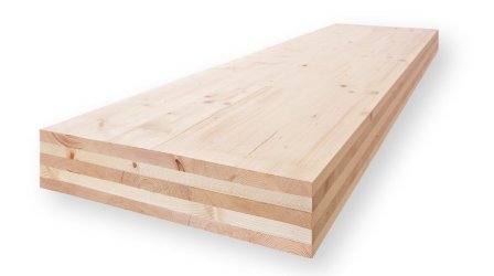

Hello, I was looking at CLT timber sheets and it is very stable but i don't understand how it is stable knowing it is cross glued wood boards and it doesn't allow the wood to expand...???
