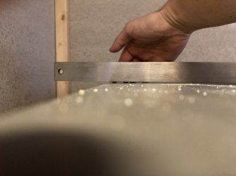

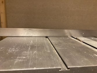

I have a question regarding a cast aluminum table saw top from the eighties that is warped. The middle of the top has become the highest point and descends from there down towards the edges, basicly creating a bow i all directions.
Does anyone have experience re-flattening such a table saw top? Do you think it would be possible?
In my head i was thinking i should be able to unscrew the top and, with the help of a completely straight plank or something, bang it straight again?
Or, should i just consider it ruined?

I believe a image of the table would be helpful. How much (mm) is the difference between the highest and the lowest point?

Hi,
Thank you both for the fast reply!
It's a significant difference. I will measure the exact distance in the mourning, but a couple of mm probably.
If a machinist take this on, wouldn't the remaning material be to thin?
Unfortunately, I believe yes. The difference is to much as I see on the pictures.
I never seen a table saw top as used spare part.
Perhaps you can get a table saw of the same type with an other damage and make one out of two.
Or sell this to somebody who use it for cutting firewood.
